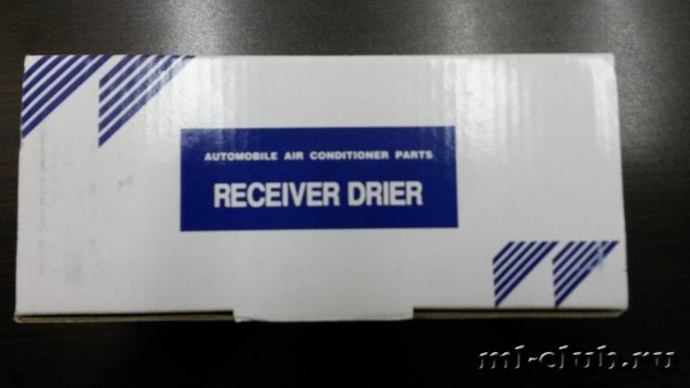

A1638300083 = HELLA 8FT351200311 = AVA QUALITY COOLING MSD362
