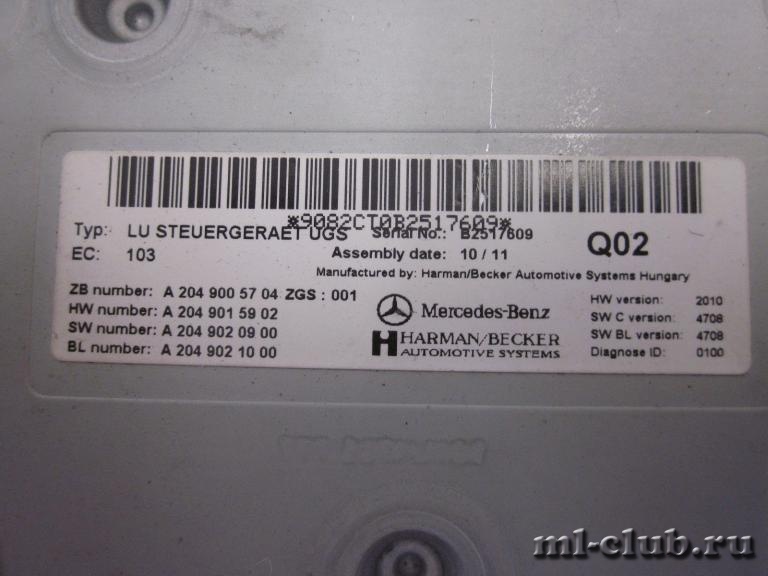

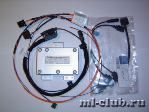

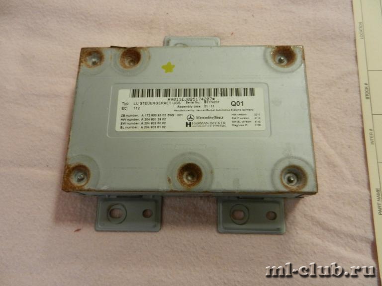

вот что нарыл
http://www.profitsnab.ru/Media-interface-Mercedes.htm
Original Mercedes Benz harman becker unit with new cables and adapters.
Media Interface Set
code 518   UCI
Audio 20 NTG2.5 with changer
Audio 50 APS NTG2.5
Comand NTG2.5,
 ntg4  w212, w204
Can not be used in conjunction with Audio 20 BLUETOOTH UNIT NTG2.5 single CD drive !!!
ONLY WITH audio 20 changer model.
For  Mercedes ntg2.5 ,ntg4
ntg4
C-Class W204
E-Class W212
E-Class W207
ALL UNITS ntg2.5 with memory card slot, HDD  :
w211 E CLASS
W169 A CLASS
VITO ,VIANO
w171 SLK
w203 c class
GL,ML,R CLASS
 functions
- Connection and control of portable devices for example (
MP3 player, via USBSpeichergeräte)
Connector and Cable
- Operation via keypad or
Multifunction steering wheel
- Video Transfer in conjunction with COMAND APS
- Appears in a display of the control unit and the
instrument cluster
- Reading of additional information such as directory structure,
interpreter
- Media Interface replaces the standard AUX-IN
connection
YOU BID FOR
1.Control unit MEDIA INTERFACE Harma Becker
2. Fibre optical loom
3. Power plug ( plus ,minus , wake up)
4. Electrical cable between unit and glove box with socket.
5. media interface adapters x 3
1. iPod
Allows full control and display of all iPod music on HDD Comand/ Audio 20* screen.
Search for Playlists, Albums, Artists etc with multiple line display. Will charge iPod when docked.
Charges iPod when docked
2. USB
Allows full control and display of all MP3 music on HDD Comand/ Audio 20 changers units !
Search for Files and Folders etc with multiple line display.
3. AUX 3.5mm Jack
Connect any audio source to play through car stereo.
Connect any audio/visual source to watch on your Comand HDD screen (viewing only permissible whilst stationary)
Can be fitted in London, ask for price 07967309202.
Thank you.
вот еще есть здесь номера.
Мedia Interface Plus (MIP) A2129004712[03] (A2129009305 или A2129004712)
устройство для обладателей системы MEDIA INTERFACE в перчаточном ящике справа или в центральной консоли (код 518). Ставится на автомобили Mercedes A,B,C,CL,CLS,CLA,E,SL,S,GL,GLK,M,ML,CLS и т.п. >2008 года выпуска.
 (Цена у дилера 17674р)
Дает следующие преимущества:
-полная интеграция с бортовой системой (COMAND, панель приборов)
-воспроизведение аудио через BT (Bluetooth) (без каких-либо проводов!)
-воспроизведение ВИДЕО на COMAND с iPod/iPhone/iPad
-воспроизведение интернет-радио Pandora
-цифровое качество звука (при подключении iphone/ipod/ipad)
-возможность чтения смс вслух
Дополнительные кабели (могут подключаться без MIP, напрямую к Media Interface):
-AUX audio to Media Inerface [plus] A0018279004 (1000p)
-Iphone/ipod/ipad 30pin VIDEO & AUDIO to Media Interface [plus] A0018279904 (1000p) & A0018279204 (1500p)
-USB to Media interface A0018279104 (1500p) (флэшки/HDD любых размеров, FAT/FAT32/NTFS)
